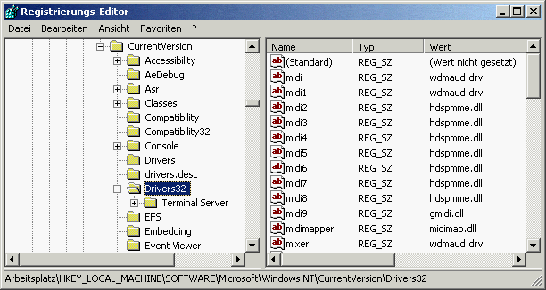

Screenshot Registry
Via 'Start/Run', the registry editor can be started by typing in 'regedit'. The relevant entries are in the path 'HKEY_LOCAL_MACHINE\SOFTWARE\Microsoft\Windows NT\CurrentVersion\Drivers32' (left part of the window). As can be seen in the picture above, in case of an error all 10 entries for MIDI (midi to midi9) and/or audio (lower end of the list, wave to wave9) have already been created.
Windows creates an additional entry when a device driver is being installed again (but not when performing a simple driver update). This means not only during the first installation, but also when:
But not only real hardware, also virtual ports emulating hardware use up entries. In the picture the entry midi9 is taken by gmidi.dll, which provides the virtual MIDI ports for Gigastudio. Even internal hardware can be problematic. The driver 'wdmaud.drv', Microsoft's WDM audio mapper, is actually only needed once per WDM (blaster) hardware, but it showed up 7 times in one of our customers' notebook - and this with an internal sound card, of which the resources never change!
The list management has another peculiarity. If e. g. the revision of the Hammerfall DSP changes and as shown in the picture above all 10 entries have been used, no further entry can be created. In this case the properties dialog shows State: Driver enabled but not functioning properly, but the Hammerfall DSP is still working completely. Because there are already references to hdspmme.dll. Its 'wrong' entry number has Windows display an error without taking the device out of the race.

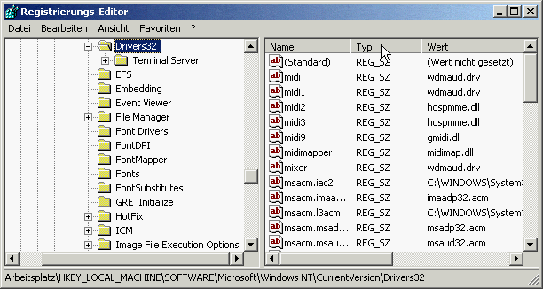

Löschen der Einträge
Registry Drivers
For doing this, you move the mouse to the desired entry midix or wavex in the right window, right mouse button, delete. But which entries may be deleted? The best thing would of course be a new creation of the list, i. e. deleting all entries midi up to midi9 and wave up to wave9. In this case you have to be sure that you have the drivers for every hardware concerned at hand. We warn against this method and recommend a more specific procedure.
Delete all multiple entries but one. As explained, the device should afterwards be functioning properly despite of an error message in the properties dialog.
In our example the procedure was easy: all MIDI entries with hdspmme.dll were deleted and the drivers of the Hammerfall DSP were installed again. This way the list of 10 entries shrank to 5. The entries wdmaud.drv and gmidi.dll were not renewed. As can be seen in the picture it is no problem, if this creates gaps in the numbering.
